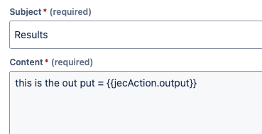

Tyler Groves May 22, 2025
Thank you @Marc - Devoteam for the quick response.
I've tried to access the smart values returned but it seems they have no value. As a test I tried to send the returned value to myself in an email (seemed easiest) but it has nothing (attached some images)
Screenshot 2025-05-22 at 16.21.23.pngScreenshot 2025-05-22 at 16.22.12.pngScreenshot 2025-05-22 at 16.06.12.png
I think it might be as you say that these features are reserved for enterprise licenced customers
For more clarity, I mean that Jira Edge Connect is running in docker and is executing the script and sending a response to Jira to confirm its completion. But it seems like it does not return and values.
Presumably this is designed to be invoked at the end of an automation rule?
