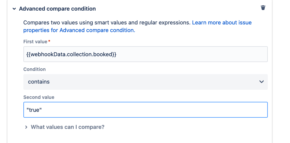

Hey, the issue I'm having with the advanced compare is that the second value after equals needs to be reresented as a string value, and doesn't seem to be getting recognised because of this:Screenshot 2022-07-15 at 10.44.35.png
Tried with and without the quotations. is there a better way to represent the value "true"? Possibly using another smart value/ regex value?
I have a work around to add the values form the webhook data to a text field and then base the condition off the contenbts of the field, but I think this way would still be much cleaner if possible.
Let me know, thanks!

Also I tried with contains to see if tht would pick up the text, also tried with capatalisd and lower case string.
Mark Segall
July 15, 2022
What happens if you use this as your first value?
{{webResponse.body.booked}}
I typically breakdown my responses from the Send Web Request action with webResponse.body.xxxx  and it works flawlessly.
Michael Savedra
July 18, 2022
Hey @Mark Segall  thanks for getting back to me.
No dice with that I'm afraid, to clarify this is for an incoming webrequest so I'm not sure it would be able to access teh response as part of the automation? More needing to analyse the data from the incoming hook.
Do the values true and false need to be represented as string values withing the advanced compare block as they are presented as strings within the data payload?
Thanks in advance
Mark Segall
July 18, 2022
Ahh - I'm understanding now.  I thought you were using the send web request action to get the data. I didn't realize this was using the native webhook functionality.  I don't think automation will be able to link to the native webhook action, so I think your workaround is the only way to go on this one.
Am I correct to assume that you're using the native webhook instead of the send web request action because you want near real-time updates and/or dealing with a large data set?  I ask because if this is not the case, it may make sense to try the API call with the send web request action instead.
Michael Savedra
July 18, 2022
Hey  @Mark Segall ,
Yeah i'm using the native incoming web request to receive ad-hoc updates from one of our suppliers (who won't be able to access the api directly).
Thanks for taking the time to look into this!
