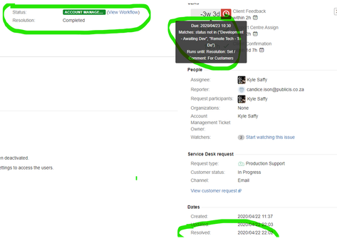

SO we have a an SLA in place for client feedback, that once a ticket is marked as resolved and if no feedback after 3 days then the ticket gets moved into closed.
how ever we seeing a number of issues as follows:
Jira SLA issue.pngwe are unsure of what we are missing, the SLA works fine for other statuses, it seems on the status above is causing the issue. Any assistance would be appreciated.

May 20, 2020
Hi @Irshad Sheik
Is it possible to you to share the SLA configuration snapshot?
Per the first snapshot, sounds like the SLA is not stopping due to the lack of "Comment for customers", but I not sure.
You can also select this status in the "Run stops" column in your SLA.

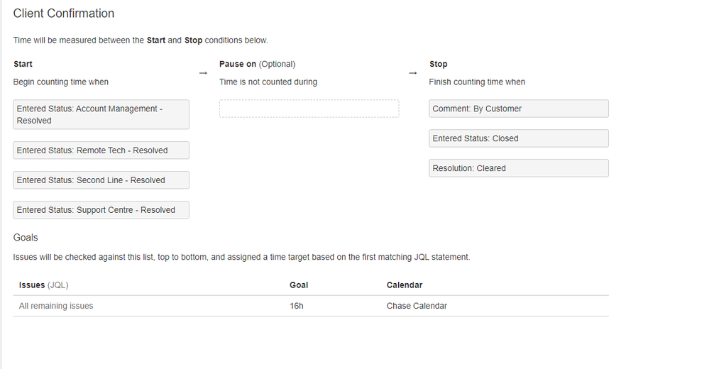

Irshad Sheik
May 27, 2020
apologies for the delay, it has been rather crazy my side, below is SLA screenshot as requested
Patricia Francezi_iDev_
May 27, 2020
Hi @Irshad Sheik
Your SLA is miss configured considering your goals.
It starts when the Status "Account Manager - Resolved" is selected, and will stop ONLY if the new status is Closed or comment by customer.
The resolution: cleared means that the "Complete" resolution, right bellow the issue status, if its taken off to stop counting.
So, if you need to stop the SLA when resolution is set to Complete, you need to select the "Resolution: Set" option in the "Stop" column.
The clock is still running because the customer didnt comment the issue, nor the Resolution was cleared, nor the status was set to closed.
I hope this helps you!

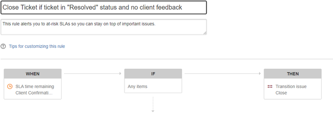

i forgot to mention that we are using the following automation:
so the issue is being marked as resolved, the SLA is completing but then the transition is taking place to move it once the timer has reached its set time.
May 27, 2020
If you dont put the "Resolution: Set" in the Stop Column, the SLA will not consider the automation for stopping SLA.
The close automation would stop SLA if the target Transition is "Closed".
If you transition for a different status then Closed, its not going to work.
In the issue snapshot, the status is not closed, thats why SLA didnt stopped.
Per the snapshot you sent about automation, i cant conclude what is the transition target.
Irshad Sheik
May 27, 2020
the automation is as follows:
Close ticket.pngso what we see is that agents are being seen as customers and as such its picking up that if the agent comments, then its recognised as client comment, but instead of putting the issue into "in progress" it just continues counting
May 27, 2020
Well, then we maybe found the issue
Check if the conditios met? - I saw an agent as request participant in the issue snapshot.
https://confluence.atlassian.com/jirakb/service-desk-agents-will-be-treated-as-customers-by-jira-service-desk-970264344.html
I still think that you might solve this putting "Resolution: Set" in the Stop column.
