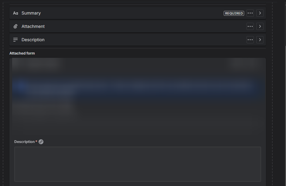

Hi everyone, I'm not sure if this was ever a hidden feature or if it was caused by a bug. I have a form attached to my request type, and the description field is linked to it, but at the same time, the description field is also included normally within the request type.
Now, when I create a new request type and try to include both, it either deletes one of them or unlinks the other.
The advantage here was always that if an agent forgot to attach the form because they created the ticket manually, they would at least always see a description and not an empty ticket page with no information.
Is there a workaround for this?

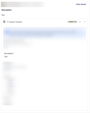

I thought that was normal, but this is the cloud environment, and about 1–2 months ago I somehow managed to add both fields without unlinking one or deleting the other. As you can see in the screenshot, they’re both in the cloud.
In the customer portal, only the form field is displayed for filling out. Once the issue is created, both the form field and the description field are displayed, which offers the advantages mentioned above.
That’s why the question was whether it was a bug or a hidden feature, since it somehow works without the field being unlinked or deleted

But that’s not the case here. Both fields work. They’re both available. In the customer portal, only the form field is displayed for filling out. Once the issue is created, both the form field and the description field are displayed, which offers the advantages mentioned above.
