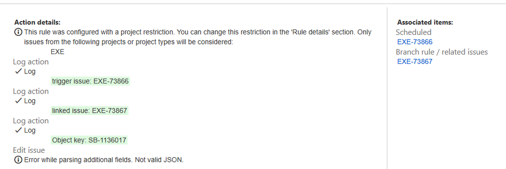

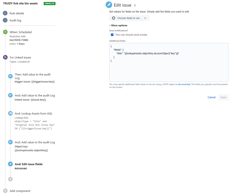

Below are my rule and the log for running the rule. For testing purposes I have limited the scope to one issue that needs updating.
Screenshot 2025-04-29 at 2.22.44 PM.pngScreenshot 2025-04-29 at 2.23.25 PM.png

The JSON expression you are showing uses the asJsonObject() function.  As written, I expect that to produce a result like this:
"fields": {
"Site": "{ "key": "SB-1136017" }"
Which will fail due to the nested double-quotation marks.
What is the type of your field, "Site"?  That earlier article was using the JSON function to help build an array of values, but that would not work for the syntax you show.
The other possible thing to check is timing problems with Asset information and the advanced edit with JSON.  I have observed problems where the JSON validation can occur (and fail) before the dynamic expression can fully parse.  (The same thing happens with the Send Web Request action for URLs and the request body.)
I recommend pre-building the JSON into a created variable first, and then using that variable in the advanced edit.  This will ensure it fully evaluates before use.  (It can also be logged to check the validity of the JSON in an external tool by copy-and-pasting the log text there.)

No worries, and based on the hard-coded example you tried, perhaps try this:
  • action: create variable
    • name: varJson
    • value:
"fields": {
"Site": {{lookupAssets.objectKey.asJsonObjectArray("key")}}
  • action: log the value of {{varJson}}
  • action: edit issue, with the variable as the JSON, {{varJson}}
That function will add the array syntax and handle multiple values when they are present.
And if that does not work, try the "update" with an "add" operation rather than "fields" for a replacement.

This was the final solution:
I did not need to add Key to the Assets Custom field configuration.
The smart value to get the object key did not need to be so complex.
Changing the Advanced Editing to this worked:
"fields": {
"customfield_XXXXX": [{"key" : "{{lookupAssets.objectKey}}"}]
Like • # people like this
