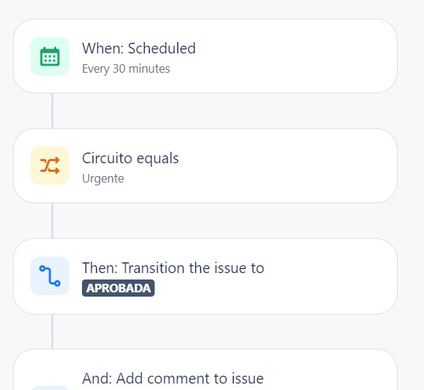

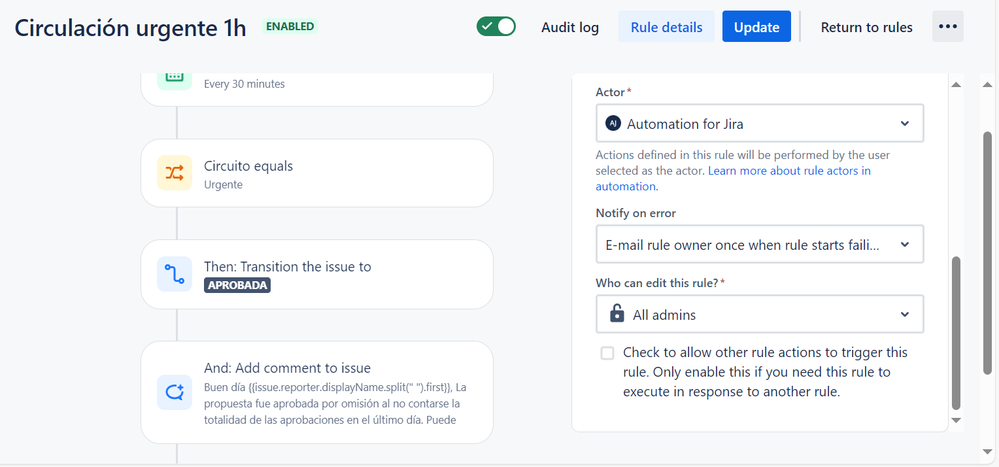

Hello community.
We have a rule that if the approvers don't approve in one day, the issue transitions to approved. When trying an automation for this, we keep getting the same error:
No transitions found for user. Ensure that the rule actor has permission (including issue security levels) to see issue and perform transitions.
We are scheduling using JQL:
project = DD AND status = "En Circulación" AND circuito = "Urgente"
Thanks in advance!

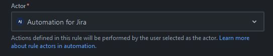

Hi @Ariane Giraud
As the error mentions "No transitions found for user. Ensure that the rule actor has permission (including issue security levels) to see issue and perform transitions."
The ACTOR doesn't have permission to
- Transition the issue
- Maybe a validator in the workflow?
First, change the ACTOR to Automation for Jira.
If you still get the error, check the TRANSITION. Are there any validators? anything hindering the movement from one status to the other?

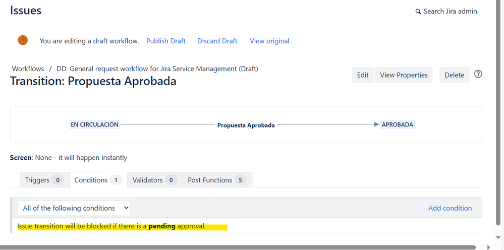

@Ariane Giraud Is there an approval step on that transition? If so, you'll need to by-pass it by introducing another non-approval based transition, or remove the existing approval to get the rule to do the transition.
That said, these kinda defeat the notion of having an approval step for that part of the workflow.
Might be time to consider, do you need an approval step if you intend to auto-approve if no response from the approver in 24hours.

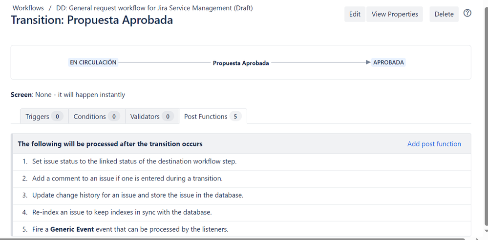

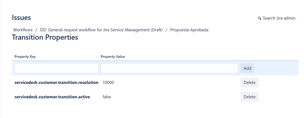

Hi Aaron, I deleted the condition as @Curt Holley suggested, but the automation still doesn't work. Here the properties and post functions:
Captura de pantalla 2023-12-20 164519.pngCaptura de pantalla 2023-12-20 164552.png

The simple solution here, if you want automation to do the transition, is to remove the condition.
Aaron Pavez _ServiceRocket_
December 13, 2023
Hi @Ariane Giraud
Thanks for the update! and yes, there is a condition that won't allow you to move to the Status APROBADA if there is a pending approval.
Please check the approval, approve it, and try the automation again.
Can you also share the properties and post functions, please?
Regards
Aaron

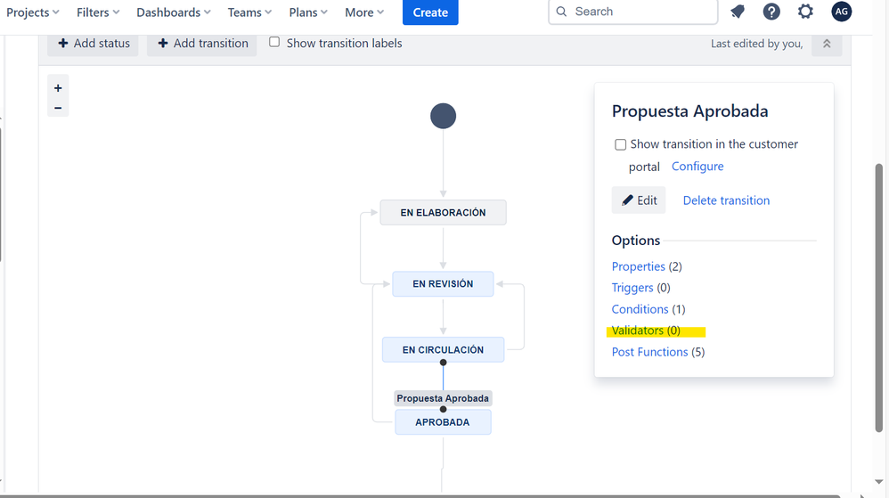

Ariane Giraud
December 13, 2023
Hi Aaron! I indeed have Automation for Jira as RULE ACTOR.
On the other hand, when I check the TRANSITION, I have no validators but one condition:Captura de pantalla 2023-12-13 164541.png
Captura de pantalla 2023-12-13 164847.pngCaptura de pantalla 2023-12-13 164920.png
