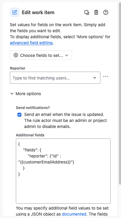

in my overall support workflow requests are collected using an external service. The external service will then forward the requests to JSM via e-mail. The from e-mail address is always a technical e-mail adrress from the external service, not the customers e-mail address. The ticket created from the e-mail then has the technical e-mail address as reporter.
The message of the e-mail adheres to a structured schema and contains the customers e-mail address. I want to use an automation to extract the customers e-mail address and then change the reporter to this address. Extracting the e-mail already works as expected. However updating the reporter does not work as expected. I'm facing the following problems:
1. Specify a valid value for reporter (reporter)
If I try to update the reporter to the extracted e-mail address I get this error in the automation audit log. I suspected that the reason for the error is that no customer exists for the extracted e-mail address yet. Here is the exact configuration I'm using:
Please note that the smart value {{customerEmailAddress}} contains the extracted e-mail address of the customer. I verified that the address is extracted correctly using the log action.

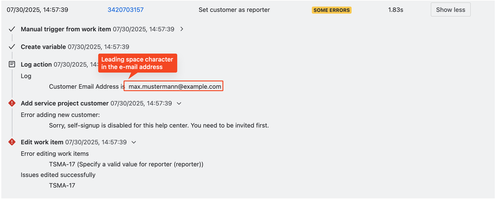

2. Sorry, self-signup is disabled for this help center. You need to be invited first.
I tried to use the 'Add service project customer' action to create a customer first. However this fails with the error mentioned above. I already ran through the steps shown from the following guide, but it did not fix the problem with the self-signups: https://support.atlassian.com/jira/kb/jsm-incoming-email-error-self-signup-disabled/

the support staff was super helpful and there were able to resolve this issue. The problem was not related to the self-signup settings of my project. It was caused by passing invalid e-mail addresses to the 'Add service project customer' action.
The e-mail addresses extracted using the regular expression contained a leading white space. Since this is not valid for an e-mail address the action failed. To prevent this the '.trim()' function can be used after extracting the e-mail address using the regular expression. Here is the working smart value:
{{issue.description.match("(?i)E-Mail:\s*([\w.+-]+@[a-zA-Z0-9.-]+\.[a-zA-Z]{2,})").trim()}}
