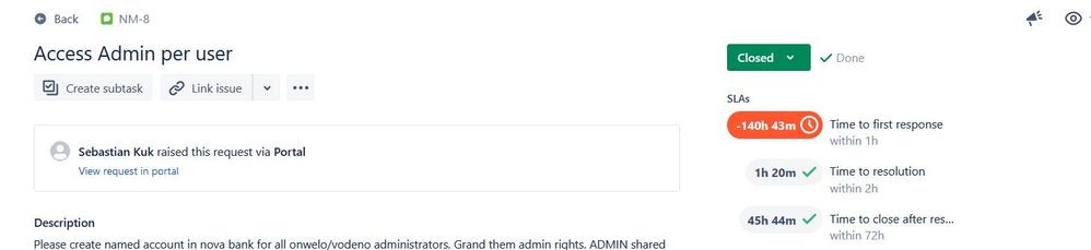

I have a problem with SLA.
Ticket is on status Resolved but SLA "Time to first response" still counting...
Example ticket

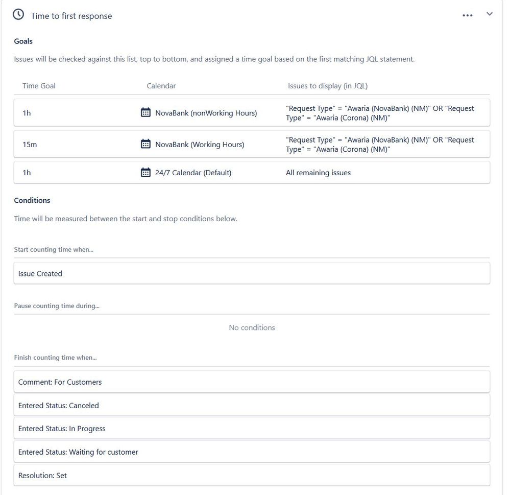

Hi @Przemysław Wójtowicz A couple of things to check:
  • Refresh the page - the SLA does not always change right before your eyes, and the page may need a refresh to show the update
  • Each SLA has it's own separate conditions, and it's own start/stop/pause options. I see that you have 3 SLAs for that issue, so double check that the Time to First Response SLA is correctly configured with the conditions configured in your screenshot above.
  • Make sure that the jql filter linked to the SLA is correctly configured so that the SLA is being applied to the correct issues

@Przemysław Wójtowicz Is the 'Issues to display (in JQL)' filter set correctly for that request type?
On a side note, seeing as the JQL filter for the top two Time Goals is exactly the same, the 15m Time Goal will never be used - as the issues are checked against the list from top to bottom and are assigned a time goal based on the first matching JQL, all issues with that JQL will have a time goal of 1h

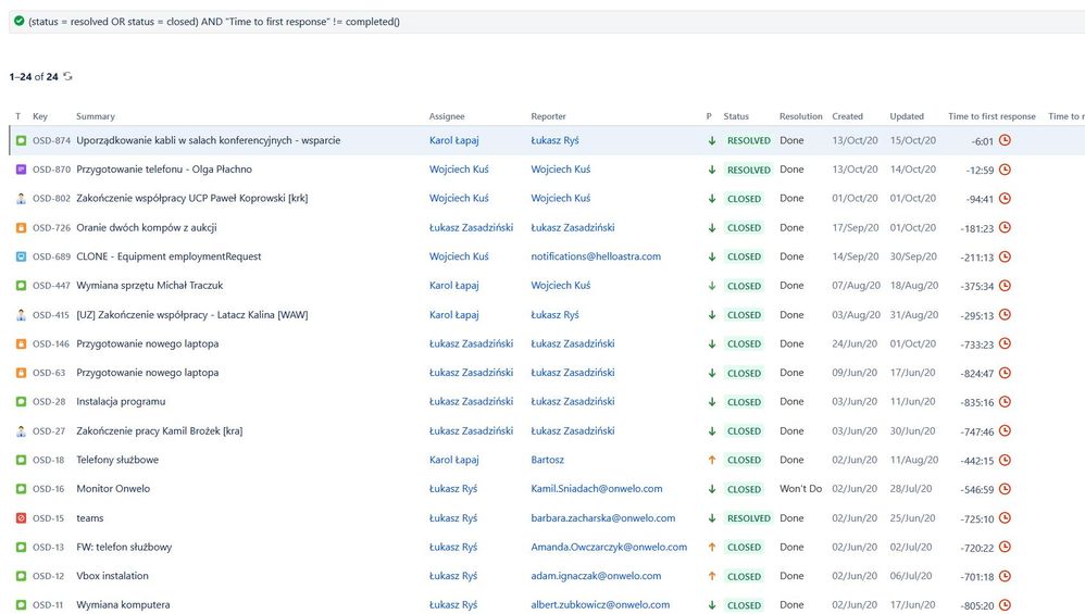

ok, but I have an other problems
hmm I have a 24 tickets with this problems (different request type, different create time)

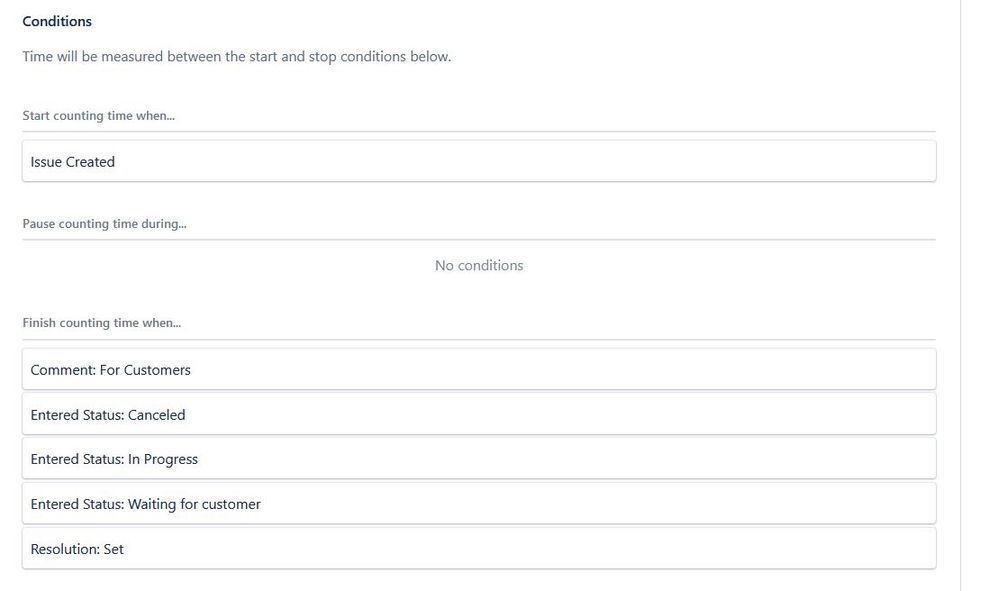

@Przemysław Wójtowicz Did you configure the SLA conditions after those 24 tickets had been resolved?
October 20, 2020
in this day I only change conditions...
Jira unable to refresh SLA after change conditions?
Callum Carlile _Automation Consultants_
October 20, 2020
Unfortunately, yeah that's correct. The conditions will only be met if they're configured at the time of the action.
If the time goal was changed then Jira would re-calculate the SLAs, but the conditions work slightly differently
