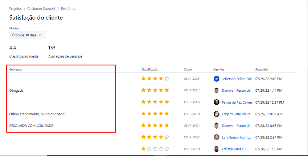

Olá pessoal
É possível criar uma JQL para importar os comentários que são feitos durante a pesquisa de satisfação do cliente?
Na imagem anexa, está as informações que preciso extrair em relatório.

@Maurício Medeiros Lima -
Take a look at the following posting in the community - https://community.atlassian.com/t5/Jira-Service-Management/How-can-I-export-the-customer-satisfaction-report-in-Jira-to/qaq-p/756814
As mentioned in the reply, CSAT comment is not stored as a custom field in JJSM.  Instead it is stored as a property of the issue.  One can obtain it via REST API call -
https://<company>.atlassian.net/rest/api/2/issue/{{key}}/properties/service-request-feedback-comment
Unfortunately, there is no way to export the report from the existing UI.  However, you can create an automation rule (using Automation for Jira component out of the box in the JSM cloud env.  The rule setup is described in the link above in details.
Essentially, the rule will be triggered when Satisfaction date changed on an issue and then perform an edit issue action where it will use smart value ({{issue.properties.service-request-feedback-comment.comment}}) to obtain the CSAT comment from the issue property and populate it to a custom field that you have to create/setup.
Afterward, you can just use JQL to obtain the your search result with the comment stored in your new custom field and export it.

@Maurício Medeiros Lima atualmente não é possível coletar as informações do CSAT
( Make Satisfaction comment searchable via JQL) , esta é uma solicitação antiga da atlassian mas não avançou muito infelizmente
Existem soluções paliativas como a descrita aqui ( How can I export the customer satisfaction report in Jira to excel? ), que desta maneira você conseguiria armazenar.
Espero ter ajudado você.
