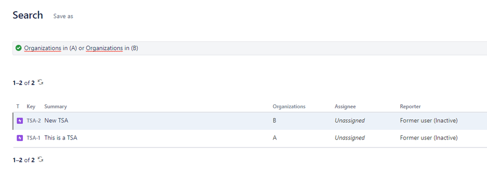

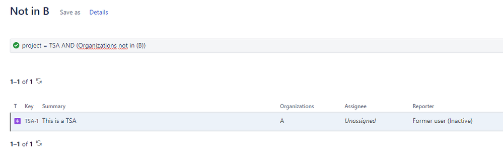

Hi @Shaumic , thanks for your question.
I was doing some tests with this and you can use NOT IN, but it doesn't work how I thought it would.
If I search for project and specify I don't want an organization, it returns the issue I have where there is an organization value, but not of organization B.
I think you might be more successful if you try to search for the positive, as in specifying the values you are looking for, instead of trying to exclude the ones you are not.
I hope this helps.
