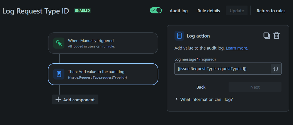

This is a peculiar issue. I don't know exactly what's wrong, but I have a trouble shooting step that may help you figure things out. Create an automation that logs the request ID of the Issue it is trigger on. Below is a screenshot of what it should look like:
Trigger this on an issue that appears properly in your query, then one that does not appear properly, and see if the IDs match.
My main theory for this is that somehow there are two request types that have the same name and icon in the Pl project. That could explain the inconsistent returns of your query. Again, just a theory, but this could help us get to the bottom of it.

Hi Christian,
Thank you for your reply and offering a solution I haven't tried yet.
I've just ran this automation for two tickets, one that shows up in the 5 for september, and one from the 3200 tickets i should be pulling with my jql request. They both have the exact same request ID of 110.
