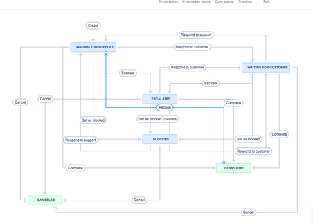

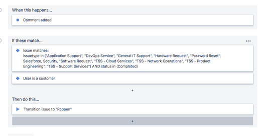

Hello,
I added a transition from 'Completed' to 'Waiting for Support'.
However I only want to allow this to happen IF its been in 'Completed' for less than 1 week.
What function would I use for that? This is what I have done so far

Hi @Harry Bob ,
Please add additional JQL query like below and automate the same with automation rules.
project=ABC AND status=Completed AND status changed BEFORE -1w
Thanks,
Avinash
