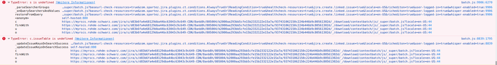

The following error is shown within the Firefox Console:screenshot_4.png
Queries like
createdDate >= startOfMonth() and assignee = currentUser()
are still working.
It seems that the issue is only appearing if I try to compare a value between multiple time (date) fields.

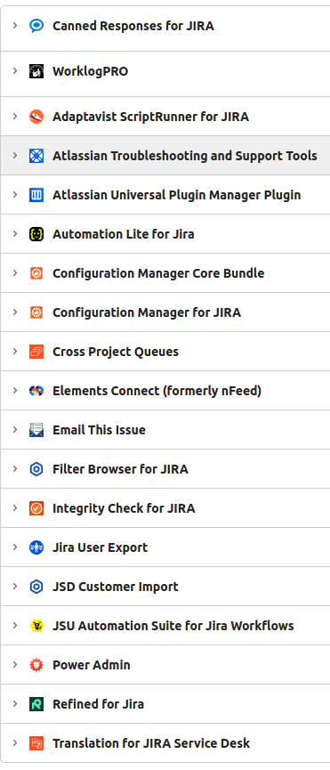

We are using the following addons:screenshot_5.png
Please drop me a line if you need additional information.

While I am not able to come up with a direct solution my idea would be to do two tests, one for another.
  1. try to put Jira to safe-mode for a short test - this will show quickly if an App is source of the error
  2. test with a different browser - this rules out a local problem with the browser on the device you are using
Let us know how the results are. Maybe someone is able to catch up then.
