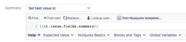

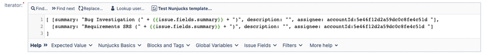

We need to create multiple sub-task tickets, in same project, when a Bug ticket is created.  Each sub-task will have a different summaries (part of it will be the summary of the Bug ticket), different descriptions, and different assignees from each other.  I have the iterator set, but somehow the summary on the create for the sub-tasks is "null".
Screen Shot 2022-03-18 at 5.28.17 PM.pngScreen Shot 2022-03-18 at 5.27.56 PM.png
David Fischer
March 18, 2022
Hi @Ashvin
the syntax to access the summary attribute of the current iterator value is simply:
it.summary
Also, the iterator is incorrect for the summary and for the assignee. Use this instead:
{summary:"Bug investigation", assignee: "accountId:1234"},
{summary:"Requirements SRS", assignee: "accountId:5678"}

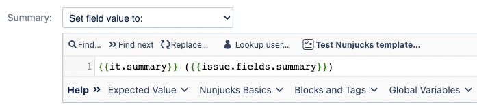

and then for the Summary field, use:
{{it.summary}} ({{issue.fields.summary}})

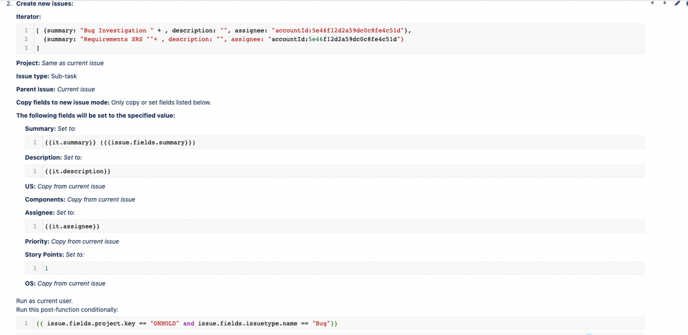

Attaching screenshots of configuration as requested.Screen Shot 2022-03-18 at 10.13.52 PM.png
David Fischer
March 19, 2022
Hi @Ashvin ,
you have an extra double quote on the second line of your iterator. Please double-check.

Second issue is that Summary of the sub-tasks tickets are including only the Summary from the "parent" Bug ticket and not what is part of the iterator.  The value of the Summary fields should be set to what is in the previous screenshot, also pasted here:  {{it.summary}} ({{issue.fields.summary}})

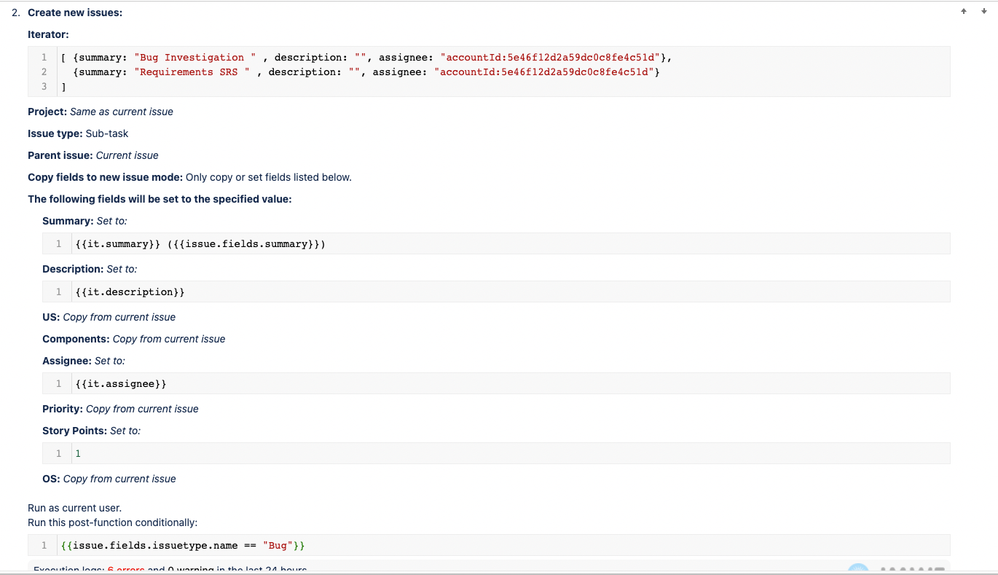

Here is the screenshot of the post-function config from the workflow:
David Fischer
March 23, 2022
Hi @Ashvin ,
you need to check the "Iterator returns JSON" option.

Right. The JSON syntax is incorrect, attribute names need to be between double-quotes. Sorry about that.
{"summary": "Bug Investigation ", "description": "", "assignee": "accountId:5e46f12d2a59dc0c8fe4c51d"},
{"summary": "Requirements SRS " , "description": "", "assignee": "accountId:5e46f12d2a59dc0c8fe4c51d"}
Ashvin
March 23, 2022
@David Fischer
Thank you once again for helping me understand and fix this post-function.  It's working now as expected.
