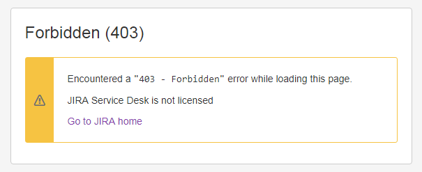

When trying to access our service desk (/servicedesk/customer/portal/...), we get this error :403.png

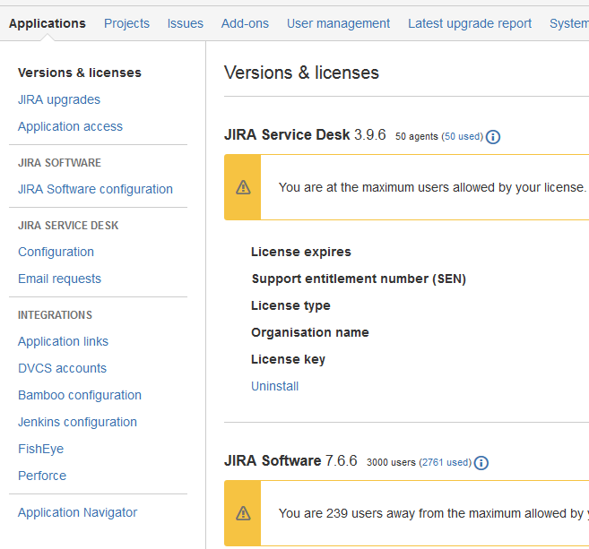

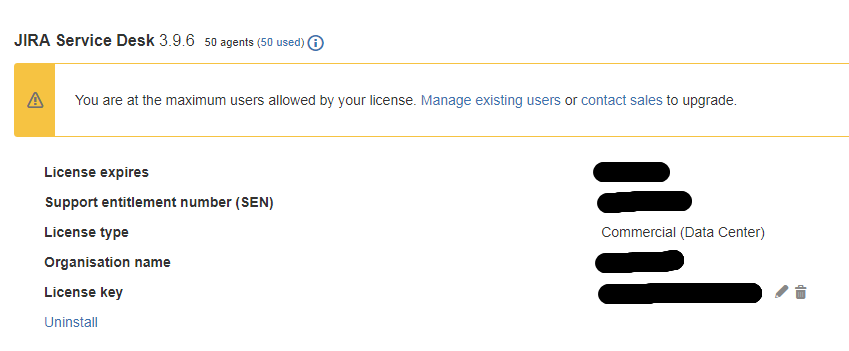

When checking licenses in admin interface, everything seems ok :Capture.PNG

We have the same problem, but clearing cashe did not help... Problem apeared after we migrate our database from one instance to another...
Kirill Putryk
July 1, 2019
We discovered that we made upgrade and my admin installed demo DTB insted of production so our problem solved.

@Eddy FrasAt least it is yellow not red( we can  classify it as warning)  i would clear  browser cache and try again  on  a different browser,  verify  your service desk  project  whether you  have  the right permission  to  view  this portal, lastly  after done  these, then  you  could try  this
JIRA Fails due to Encountered a 403 Forbidden error loading this page

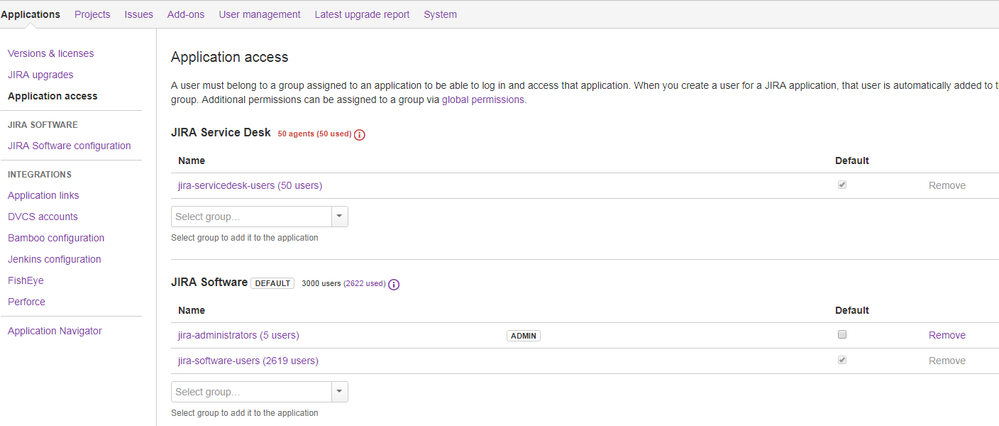

@Eddy FrasWhen  you  click  application  access,  what  is displayed?
Eddy Fras
June 22, 2018
I got this :

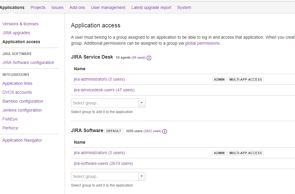

Moses Thomas
June 22, 2018
@Eddy FrasYou  see that  you don't have access,  add group jira-adminstrators  as  admin,   under  Jira  Service Desk  i believe you are in this  group you  will  be fine  :)
Eddy Fras
June 25, 2018
Hi !
I'm already part of jira-servicedesk-users so I have access to JSD.
As said previously, I was able to access my JSD portal once when I cleared my browser cache so access rights are OK. Now, for an unknown reason, I can't access it anymore.
I tried anyway your solution (adding jira-administrators to JSD) but that's not better, I still don't have JSD menu items in the left panel :
