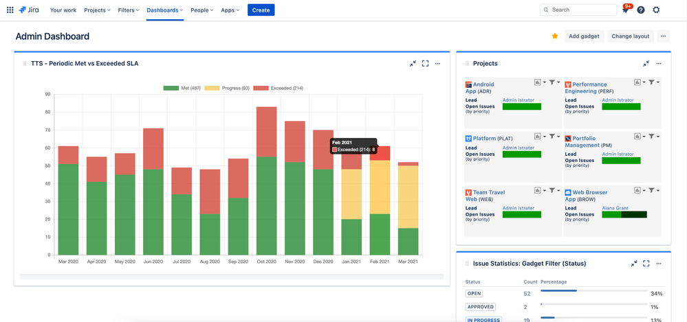

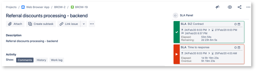

You can track the progress on your issues and tickets in Service Management and Software (also Business) projects, you can try Time to SLA.
With Time to SLA you can define SLAs, track them through SLA panel, show linked issue SLAs, extract reports, send notifiers to stakeholders and show SLA information on dashboards with the TTS gadget.

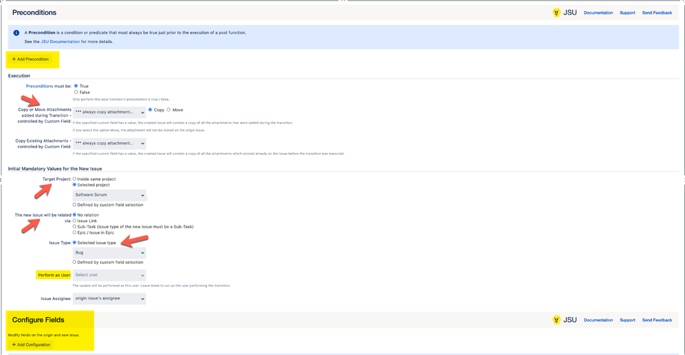

Yes, you could achieve your use case using JSU Automation Suite for Jira Workflows.
In the JSM's project workflow, add a "Create A Linked Issue (JSU)" post-function (On create transition or any other transition(where you want to create ticket in another project)).
Here, you can create a new ticket of a specific issue type in a specific project and link it to the original issue. Please refer to the screenshot below, which shows the available configurations in this post-function :
Refer to our documentation on Create A Linked Issue (JSU) post-function
