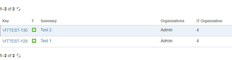

I am having a problem copying the (system) JIRA Service Desk Field Organizations to a (text box) custom field. I am using a post function Copy Field Value via the JMWE add on that allows me to do this with any other fields.
It seems as though Organizations has a different kind of value than the name I gave it. What I am trying to do is copy the Organizations value "Admin" to the custom field "IT Organization." You can see via the screenshot that the value "4" gets copied to IT Organization."
Is there any kind of work around in order to get what I actually named Organizations (Admin) copied onto a custom field?

Hi Michael,
You should be able to achieve this by using the 'Set field value (JMWE add-on)' post function.  This allows you to set the value of your new custom field using a Groovy expression.
  1. Select your custom field, 'IT Organization', in the dropbox labeled 'Field'
  2. Change the 'Value type:' dropbox to 'Groovy Expression'
  3. Enter 'issue.get("Organizations")*.name' in the text area
  4. Click 'Add'
The output in your IT Organization field should reflect the Organizations name now, rather than the ID.
