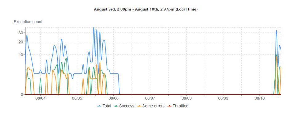

Maybe due to the maintenance window from 6.8.22? This would explain the graph until the update of the addon today in the administration section:
Hope this works for you as well!a

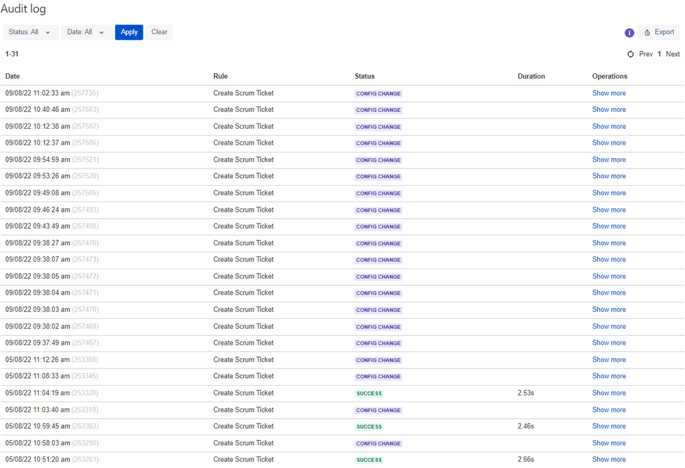

Hi Joseph, thank you for your response. Here is a screenshot of the audit log:
You can see that I was having success on August 5th, but no further issues have registered. All the config changes are me trying to get it to work afterward.

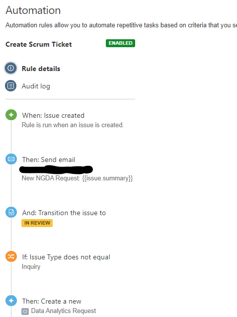

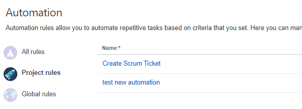

I am sure that this is a project rule by this screenshot:
Not shown in this screenshot, but the project is correct and where I am creating issues (when testing, I click on the "Raise a request" icon within the project). And it is "Enabled."
