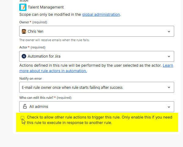

Regarding problem 2, does your 2nd rule have the '... allow other rule actions to trigger this rule ' checked under Rule Details?
2025-10-23 11_39_15-Rule builder - Automation - Talent Management - Jira.png
