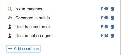

I had this issue when I first started with JSD. As I recall it had to do with the fact that by default the automation was setup to transition back to Waiting for Support if any comment was made. I suggest you look at the Transition on Comment rule. I have mine with the IF setup as below

Thank you. That sounds likely, however, I don't see your IF setup.
Jack Brickey
June 14, 2017
sigh...a limitation or interop bug with Safari and pasting. let's try again.

it is usually best to create a new issue for those questions answered this encourages a clean thread. With that said let’s dive in here...
Typically the transition should occur when you use the transition button not the public comment button, IMO. I think the transition button is ā€œReply to customerā€ but don’t have my instance in front of me at the moment. So can you confirm whether you are using the ā€œReply to customerā€ means or the ā€œShare with customerā€ comment? The reason for this is that you don’t always want to transition when you share a comment. Generally you want the transition to be directly actioned.
However, looking at you automation above it appears that maybe you are using ā€œshare with customerā€ comments to transition. If that is indeed desired then we will need to peel the onion a bit more.
