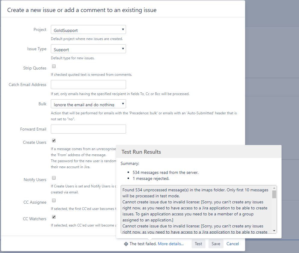

When I check the Mail Handler and Test it, it is returning the error attached.
PLEASE HELP - this was working without issue on my personal instance......

Mary, ok so hang on a second. I think i see a (the?) problem. It appears you are using the Jira incoming email handler rather then the JSD email channel. Please have a look at project > project settings > email requests. You should have your test email configured there. I may be mistaken as you are on Server and I on Cloud.
