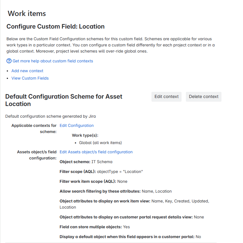

This is the configuration of the field in Jira:Location Configuration Jira.png

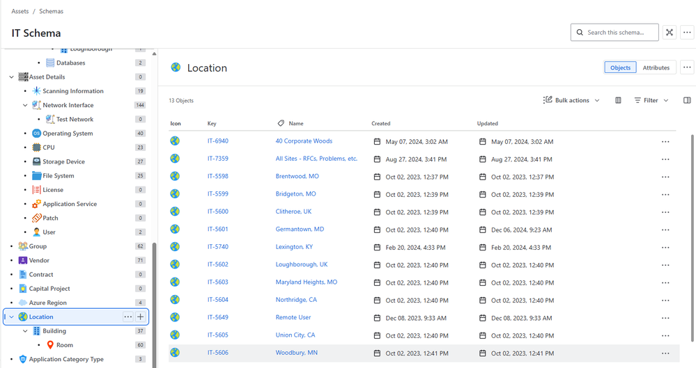

This is how it looks in Insight:

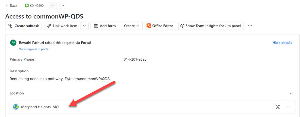

We see the locations on the tickets after being submitted via the portal or email:

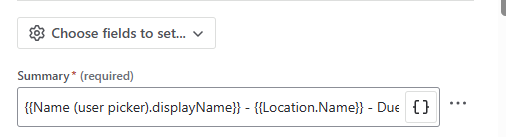

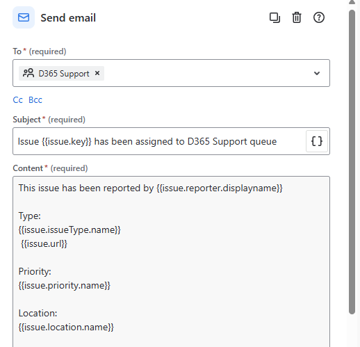

However when the automation sends an email or creates sub-tasks the location does not appear.
