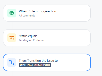

I'm running into an error with my Jira automation rule, and I'm hoping for some guidance or workarounds. Here’s the situation:

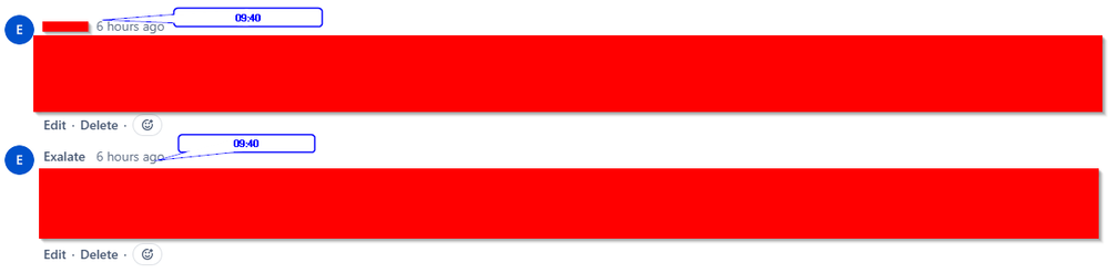

I have an automation rule set up to transition an issue to the "Waiting for Support" status whenever a comment is added, provided the current status is "Pending on Customer." In general, this rule works smoothly. However, when two comments are added almost simultaneously (within milliseconds of each other), the automation fails on the second attempt. I get the following error message:
Transition issue Error transitioning issues PR-XXXX (Can't move (PR-XXXX). You might not have permission, or the issue is missing required information. If you keep having this problem, contact your Jira Administrator.)
The issue isn’t related to permissions or the workflow settings. The error occurs because the second attempt to transition the issue is trying to move it to a status it's already in, due to the first comment-triggered transition occurring milliseconds earlier.
Is there a way to prevent the second transition attempt from failing if the issue has already been moved to "Waiting for Support"? Or any other workaround to handle simultaneous comment-triggered events?

Hi @Konstantinos Sotiriou
If the first automation works, is there a why you care the second fails?
The second will fail since the automation has run and the status has changed.
This is a race condition that doesn't have a fix yet.
You can either
- Add a delay (there is a new action for that in the automation)
- Refetch (this might not always work. Set it as the first action to fetch new data and see if the status hasn't changed.
November 12, 2024
Hi @Aaron Pavez _ServiceRocket_
Thank you for your reply.
If the second run fails, I receive a failure email and need to check on the automation each time fails.
- I’ve tried adding a delay action, but it delays both runs equally, so there’s no effect.
- Yesterday, I also added a re-fetch action. I’m not sure if it’s working yet, and I’ll monitor it over the next few days to see if the error triggers again.
November 14, 2024
Re-fetch also didn't work.
November 14, 2024
Thank you @Aaron Pavez _ServiceRocket_
This is how I’ve implemented it, by changing the status when the customer adds a comment.
We use Exalate to sync issues between our ITSM and the customer’s system. Often, Exalate syncs changes every 1-2 minutes from the queue. So, if two comments are added within this time window, they will be posted simultaneously to my Jira project.
That’s really the issue.
Thank you again.
