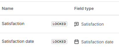

Hi @Christos Markoulatos -Relational- - CSAT was always enabled in both projects since the start of the project. I also only have the default fields in the system and nothing else with the name satisfaction

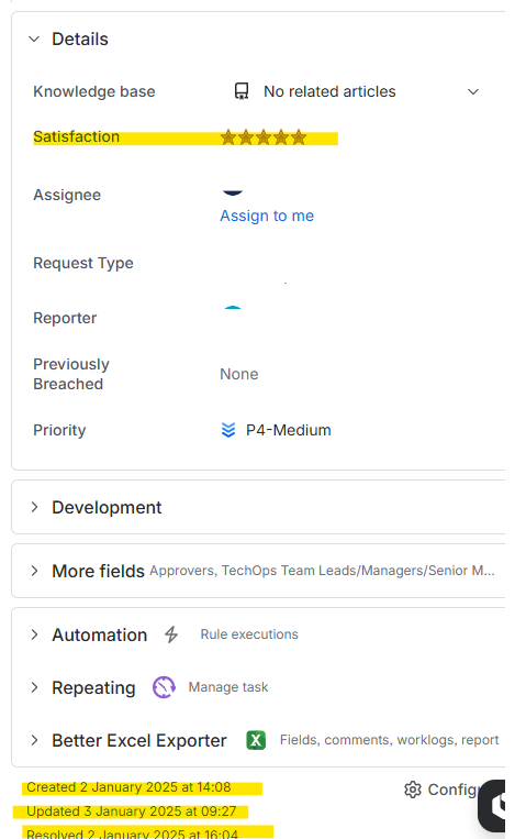

I also am attached an issue from January 2025 in the same project where the satisfaction is filled in but not being picked up in the filter.
February 4, 2026
Hi @Drishti Maharaj
Since CSAT has been enabled from the start and you've confirmed there are no duplicate fields, this is indeed puzzling.
The only other thing i can think of is field context configuration. Even though both projects have the same "Satisfaction" field, they might be using different contexts, which could affect how data is queried.
