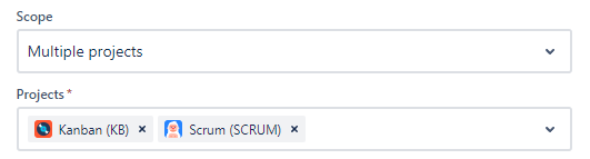

I think the issue could be the scope of your rule/s. If you limit the scope to single project A or B they will not trigger each other. You should enhance the scope of the 2nd rule to both projects:

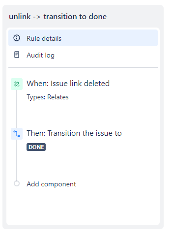

For me, this simple rule did the trick then:
I deleted the link in SCRUM project issue (your Project B) and the former linked KB issue (your A) got transitioned to DONE.
