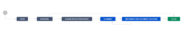

The workflow:

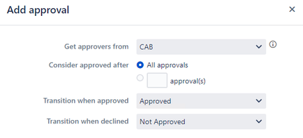

The approvers will be any users in the CAB field, following this approval configuration:

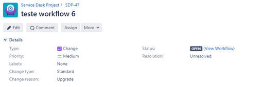

This is the issue before entering the approval phase:

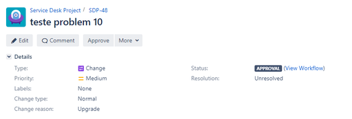

This is the issue in the approval phase (not the same issue but it follows the same workflow):
For both of those issues, the approver is the same.

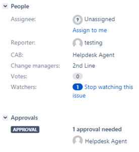

The image does not include the Approvers and CAB, can you post the whole issue screenshot?

I apologize again for the late reply. Here is what you requested:
Thank you.

Are you logged in as Helpdesk Agent or are you logged in as testing?
Miguel Santos
March 2, 2020
@Viktor ,
I am logged in as testing.
Viktor
March 3, 2020
Then you need to add "testing" to the CAB field
or login as "Helpdesk agent" since that is the only user in the CAB field

Can you change the workflow to "Consider approved after: 1 approvals" instead of "All approvals"?
Miguel Santos
March 5, 2020
@Viktor ,
I have tested this, the outcome is the same. I added the user "second" to the CAB field, logged in as that user and approved the issue, but it did not transition to the correct workflow status.

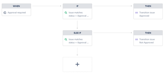

I tried the following rule:
image.pngIt basically says that, when an approval is required, and the issue is in the "Approval" status AND the approval = approved(), it transitions automatically to the next status. When the issue is in the "Approval" status AND NOT approval = approved(), it transitions to the "Closed" status.
This does not seem to work, when I press "Approve" or "Decline" it still does not do anything, is my rule not created correctly?
