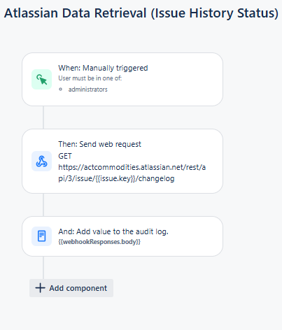

I have a bunch of old tickets that have been closed, of which I need to retrieve data from, specifically the moment when the ticket went into the "In Progress" status. I already have a list of tickets for which I need this data from and I see that in the Issue history of the ticket, the timestamp of the status change is present.
I want to pull that data and place it in a custom field. Since its quite a number of tickets, doing it manually will take ages. From research I have seen that this can potentially be achieved via Automation and using API to pull that data. However, it is with the automation I am stuck at.
I have followed the instructions of the Atlassian Developers article on which API to reach in order to get the changelog data. However, everytime when I either validate the web request by using an example ticket or when I run the automation on said ticket, it returns with an error:
{"errorMessages":["Issue does not exist or you do not have permission to see it."],"errors":{}}
The actor of the rule is "Automation for Jira" and it should have access to the tickets, but I still get this error.
Even when I ran the automation with a different actor (which has access to all projects), it still gives
the same error.
Does anyone have an idea what could possibly be the issue or is this a lost cause? I am
not in the position to purchase any add-ons so kindly refrain from suggesting marketplace
apps for this.

@admin-nwalter -
Just an idea - Have you try to use some scripting outside of automation rule setup to conduct the Webrequest to determine the same errors happen?
Secondly, did you also ensure those issues are not archived?
I would also recommend that you contact Atlassian Support (https://support.atlassian.com) to obtain their inputs too.
Hope this helps.
