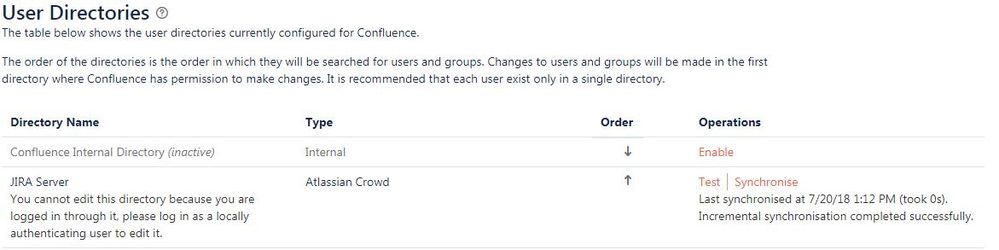

I checked our current setup and we do share the users between Jira and Confluence. Here is our setup:

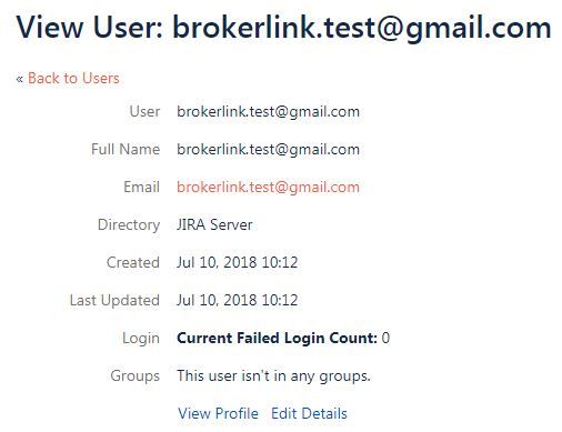

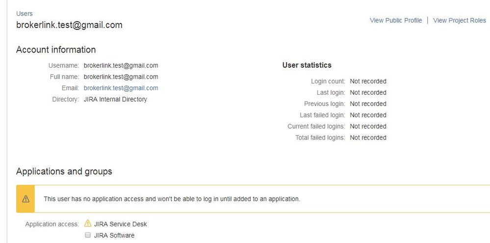

And here is an example of a user who reported an issue via email:
In Confluence:
The same user in Jira:

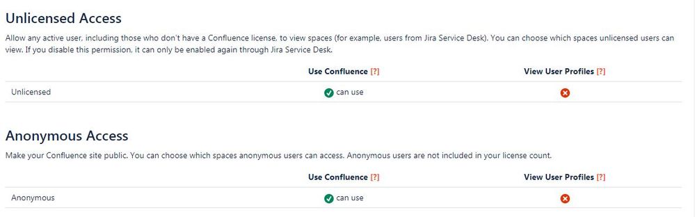

Confluence Global Permissions:

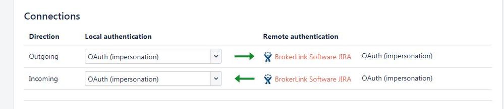

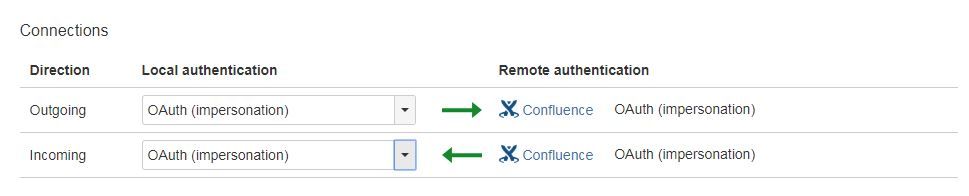

Hi Andrew, here are our settings:
Jira Application Links:
Confluence Application Links:

Hi Liana,
In your case I think the application link looks fine.  But given the steps you have described, the end user is going to need to have a login for both Jira Service Desk (first) and in this case Confluence to make this work.  If users are able to create a service desk request via an email, they already have a login for Jira Service Desk.  Maybe they are unaware of what that is, but you can't create issues in Jira without it.
