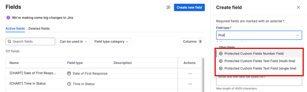

You can use it to restrict specific custom fields to specific user groups. It’s completely free and very simple to set this up:
1. Create a new protected number field for salary (Work items > Fields > Create new field, then select the Protected Custom Fields number type).
2. Give your relevant user group (e.g., HR, finance, line managers) access to that field in from the app's settings screen.

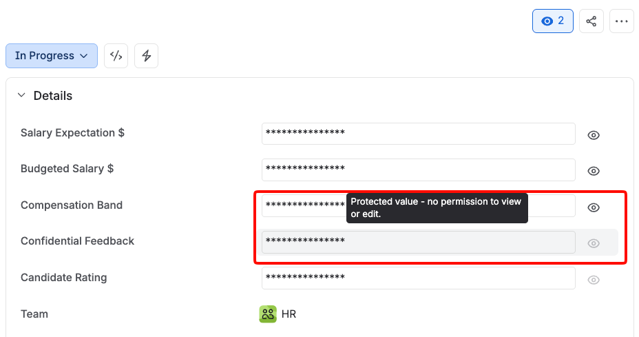

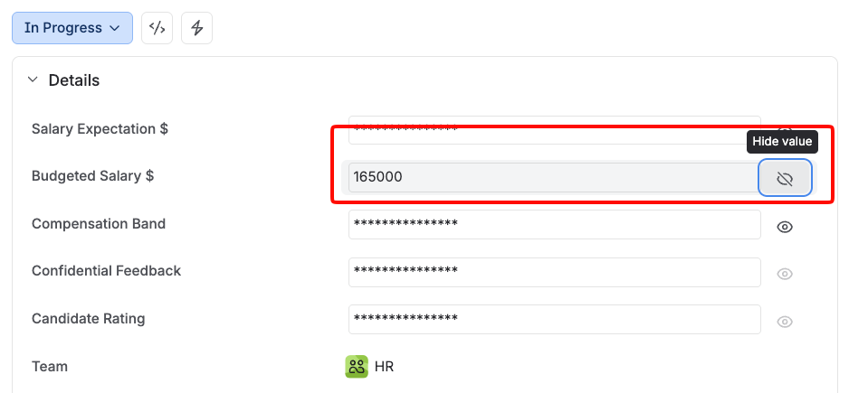

If you have access, you can reveal the field:
If you don't, you can't see what's stored in the field:
Naturally, you can have multiple protected fields assigned to multiple user groups on one work item, so it's as flexible as you need it to be.
