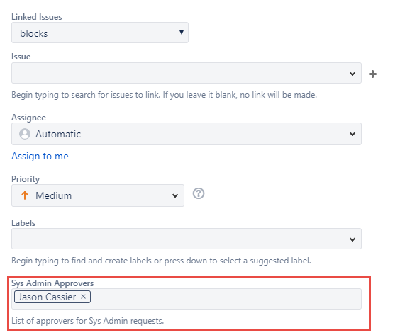

I understand that you can add a default set of approvers, but can you make it where users cannot just add anyone as an approver?  My goal is to prevent a user from putting themselves or an unauthorized approver from easily bypassing the approval workflow.

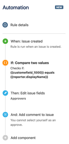

Automation For Jira:
AFJ is another addon I strongly suggest everyone to use. You don't need any coding experience for this app and it allows you to add advanced automation to your projects.
In this scenario I made an automation for you so you can see what it would look like. Unfortunately, the trigger would be the issue being created but once it is, the automation would run. Once it runs it would compare two values, "Sys Admin Approvers" and the reporter field. It will be checking to see if they contain or equal eachother (depends on if the approver field is a multi user picker). If they do, the automation will clear the approver field and add a comment telling the reporter that they cannot add themselves to the approver list.
AFJ also has a free version but it does limit how many automations can run a month (300)
