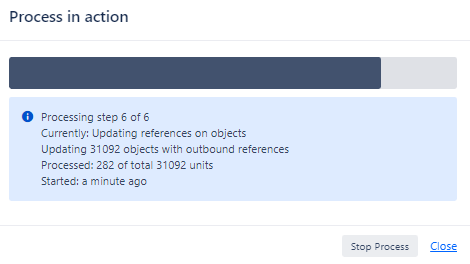

I have a problem with importing a larger number of objects.
On some large object types, I got importing time, which is taking an hour or even longer for about 50000 objects (some with references to even larger object types).
Most of the time (more than 95% of the overall time) is spent within the last step to create the references.
Are you aware of any ways to improve the performance of this step?

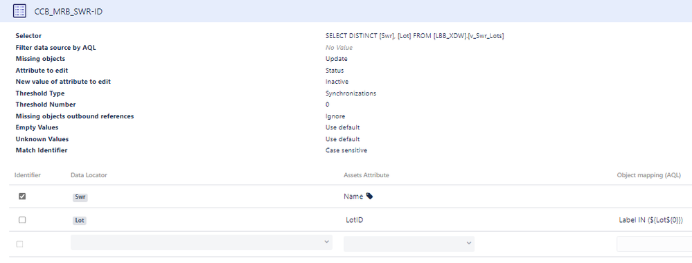

thanks for that. I noticed this document is for Cloud only. And it basically describes how to link objects to other objects. That is what I am doing, which is why the last step (Updating references) is executed at all.

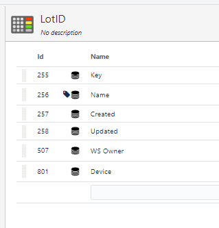

We are running on a Server instance, so the article does not apply completely, but if I did not misunderstood this, We are already doing this. This is the configuration we are running. The object type LotID is referenced by another object type. Unfortunately LotID holds more than 600k objects. And also the new object type is holding about 30k objects.
I am a little concerned about the amount of references to be updated. It seems the import updates all objects available even if almost nothing has changed. Is this the expected behaviour? Or did I miss anything in configuration, which is forcing this to happen?
Thanks for your help!

Sorry took so long to get back to you, "thinking out loud"; if swr  is unique and you are gathering those unique as criteria 1 and then you are looking for Lot that is also unique. so the combination of swr and lot are unique to one record. if you put check mark next to lot and turn off the case sensitivity that might make it run faster because it knows the combo of swr and lot together are a unique id instead of doing pass 1 swr and then lot. (fingers crossed)
