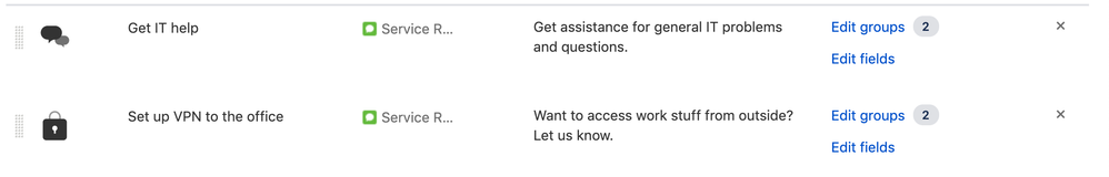

yes. simply go to project > project settings > request types, edit groups and uncheck all groups. it should then show under "Hidden from portal"

Hey @James_Styles ,
What Jack is talking about is shown in my screenshot below. On the right side of the request type, there is a button called Edit Groups. Jack is saying to click that and to make sure the request type is not affiliated with any groups.

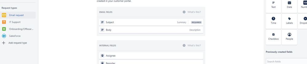

Hi Cody,
When I click into Request Types, I don't see what you attached. I get a view that looks like this that looks directly into the request type itself. I don't see a summarized view like you're seeing.
Oh you are in Next Gen. That is a completely different style of Service Desk and unfortunately I do not believe there is a way to hide a form from the portal in a Next Gen project. Next Gen is still in Beta and they are constantly adding features from classic projects into Next Gen.
Found a way to hide in Next gen.
Project settings -> Channels -> Customer portal -> Customize portal
Then, click the request type you want to hide, and remove 'General'
