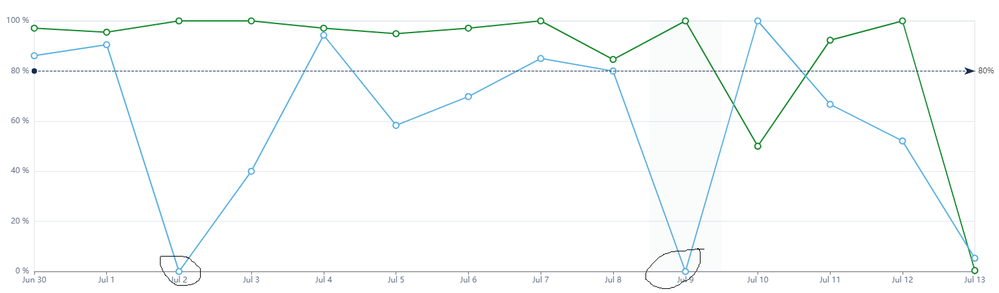

The one thing that´s bugging me when using the built-in SLA, is that when an issue is created over the weekend (when the SLA is configured to not count) it still shows up in our SLA reports, dragging down our percentage in First Response and Resolution. Even though I configured the SLA not to look at weekends. I hope to resolve this using the 3rd party solution.

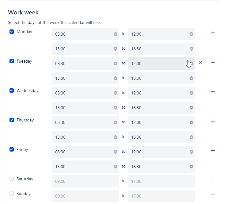

Hello @Pétur Björn , can you provide a couple of screenshots please? It is possible that you aren't setting a configuration to pause your time but I won't know for sure until I can see it.
Pétur Björn
July 13, 2022
Here you can see 2 saturdays showing up in our SLA success rate report
Pétur Björn
July 13, 2022
2022_07_13_08_47_04_Tækniþjónusta_Haga_Service_level_agreements_Service_project_Jira.png
