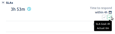

If you transition from an "active" (Start) state to a "Stop"-state, the SLA will be stopped (obviously). When you transition back to a "Start"-State again, the SLA will re-start counting from the ORIGINAL value. (Say: SLA time was originally set to "4hrs", it will start @ "4hrs" again when re-transitioned to the "start" state.)
This will even be indicated on the ticket itself (two checkboxes - ticket was "re-transitioned" in the example):
Rather late response to your question, but maybe it still helps.
