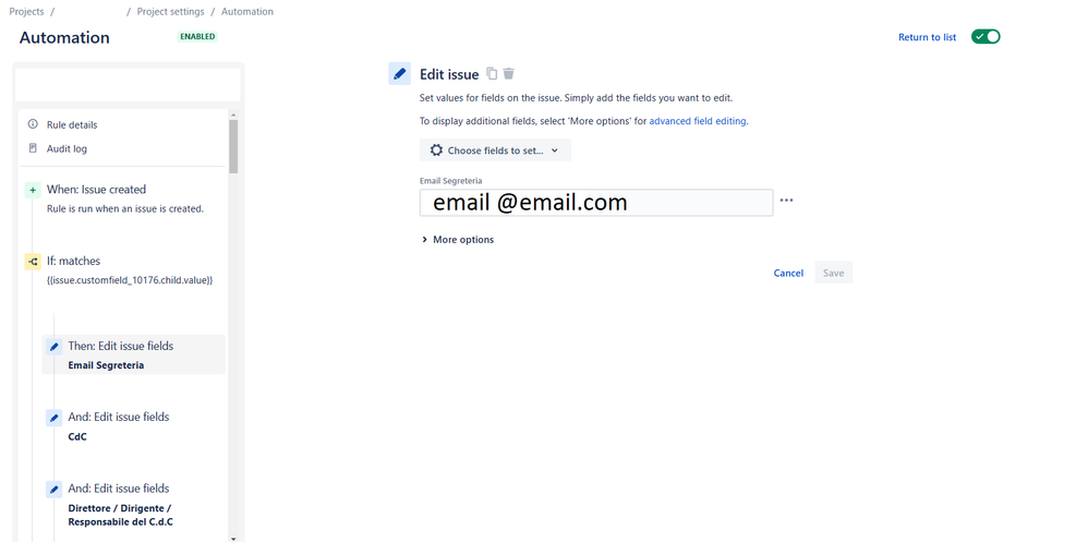

I have understood that you want to populate some other values in an issue that are based off of an attribute of the ticket. I have an example of an automation rule I have implemented for a  customer that I think might help you.
Please take a look -

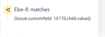

Here, when the user submits the request form from the portal, or opens an email in the JSM project, the trigger is called when the issue is created in the project.
Then, I have a condition which goes to check, in this case, where the department is this value, then edit the secretary, to insert an email, then edit the cost centre code, inserting a code, and then edit the approver, again inserting an email address into the issue.
THEN, I have an else clause to check if it's not department A, what value to insert for department B, C, and so on.
Do you think this would help you to get your result?
