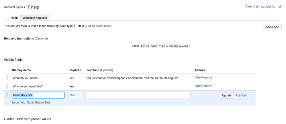

The workaround consists in making the custom fields mandatory in the request type form:
By making such fields mandatory, it won't be able to set them via email (since emails can only be used to set the ticket summary and description), and the emails will be rejected by the Service Desk Mail Handler (configured in Project Settings > Email Request), since these fields are mandatory.
It is important to note that the customer won't be aware that the issue failed to be created, since no notification will be sent to this user.
