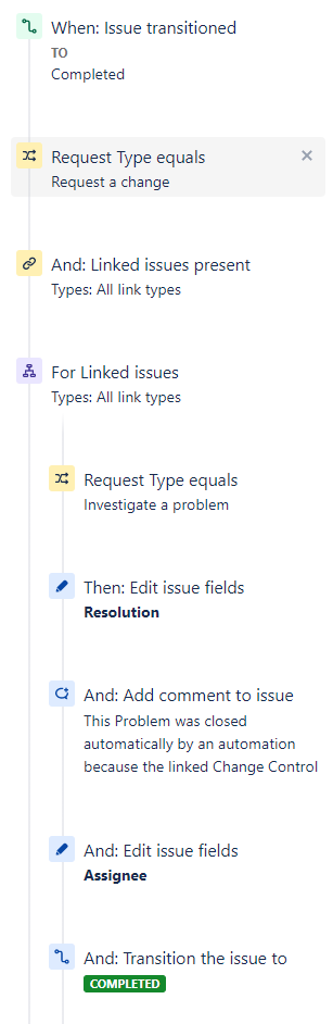

I do have one outstanding issue which I can't figure out:
This is my automation flow:
The bit which fails is the setting Resolution to Done - in the middle.

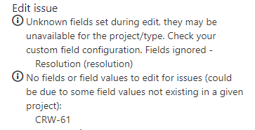

The Error track says:
But the issue in question is a Problem, and definitely does have a Resolution field, which should be able to be set to Done.
Any ideas on that??  Any more info you need?

Good morning @Pete Blake -
Looking at your automation, you don't need to edit the field RESOLUTION.  This field is typically (default) set as a part of your WF transition via post function.  You need to verify in your WF that resolution population is there in the transition's post-functions and ensure it is set to "Done".
Once it is verified, then remove the edit RESOLUTION field step from your automation setup.  Resolution field should be set in the WF configuration only.
Lastly, Automation rule setup is at the project by project level only.  I am not aware of any functionality where one can create global automation rules.  You may be able to share project configuration when you create new project, thus the automation rule setup can be shared among projects.  However, you will need to test it out.

Pete Blake
May 12, 2021
Hi @Joseph Chung Yin
Thanks for your response.  That seems to have solved the problem!
Thanks very much for your help.
