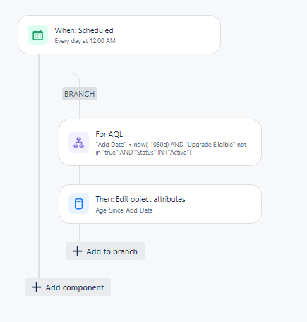

Welcome to the community! What your proposing is definitely possible using a scheduled global automation paired with an AQL search and then using the action of "Edit object attributes" I'll post a screenshot of one of my rules below that checks if a workstation is 3 years old then it marks it as eligible for upgrade.
One limitation I've observed is that if the amount of records is too large it doesn't update all of them, it seems to cap out around 20 from what I've seen which is why I try to capture a range and have the job run once an hour before business hours so if it doesn't catch it in the first round it will hopefully catch it in the subsequent rounds. A dashboard query would be more reliable but I believe it will need to be built in Analytics which not everyone has access to
