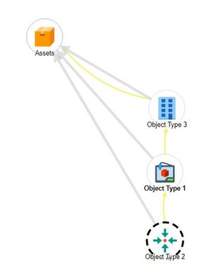

I have the following object structure:
With the following structure of Object Type:

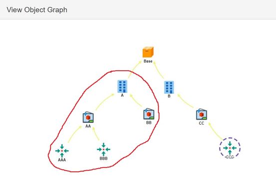

Question 1: How can I filter (IQL) all objects belonging to a specific root object (e.g. object A) as shown:
Question 2: Assuming that all objects have a state attribute. Changing the state of the object A, can I change the state of all the objects that follow it?

Hi James.
      Answer 1:
Try:
objectType="Object Type 3" AND Name="A" OR object HAVING outR(Name="A" OR object HAVING outR(Name="A"))
Did not test here - but should work.
     Answer 2:
Yes, this can be done with an Automation Rule for Object Updated where you execute your Groovy Script which will update the Status Attributes of referencing Objects (we do have some examples, but you will have to develop the script, to get the referenced Objects in order to update them).
