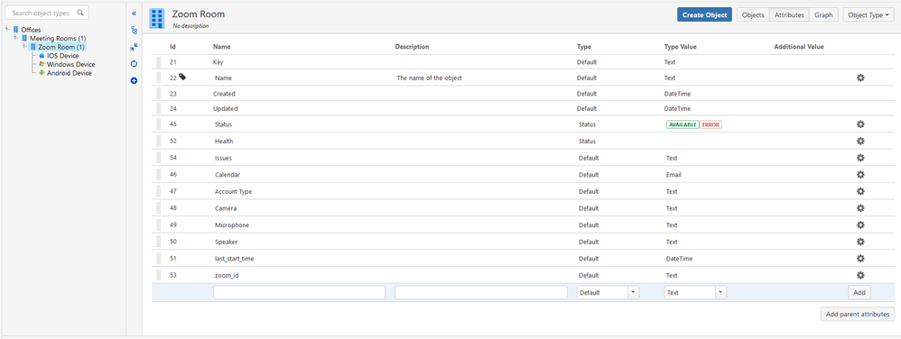

Invoke-RestMethod : {"errorMessages":[],"errors":{"rlabs-insight-attribute-22":"At least one value must be set"}}So this is what my object looks like. (Removed the link to parent object for now.
As you can see I am just going to import some zoom rooms and link the assets between the rooms, and the hardware in said room.
This is my simplified script, trying to just create a object with a 'test' label and nothing else.

I got it working on a completly fresh cloud instance, so my id's are 1 fore the objecttype and 2 for the atrribute.
Here is my JSON:
