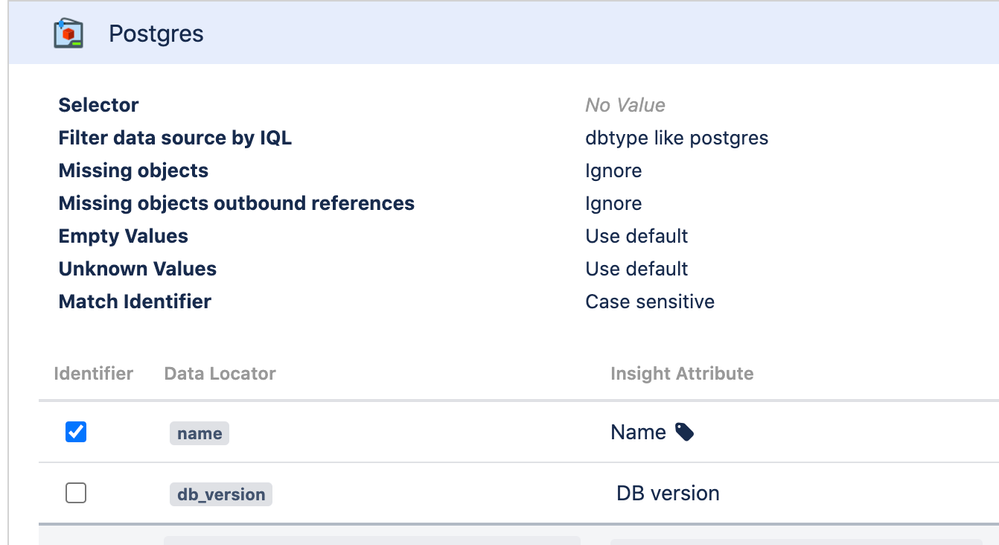

Björn Gullander
May 3, 2021
Hi
I'm not 100% on that this solves the problem for you but I tested with this configuration and it seems to work fine.
What is important to note is that the "Filter data source by IQL" is not run on the source columns but on Insight objects created during import. This means that you need to store the db_version into an attribute in the target object type - in my case I call it "DB version".
In your case you may benefit to use inheritance to be sure your DB object types contain exactly the same attributes.
