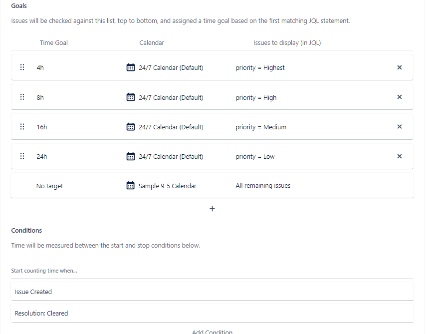

I've checked the SLA configuration for my project, and nothing seems to be out of place:

Hello @Nor Liana (AKATI Sekurity)
It seems JD has some defects.
Another thing is your start condition: Issue created & Resolution - Cleared.
Please check what the resolution Jira posts automatically when an issue created.
If it set Cleared by default, then it seems some defect here.
If you set it manually, then check the history of when the Start event happened (Created + Cleared) and what's the conditions for Stop and Pause.
I hope it helps
October 16, 2020
This was it!
I didn't notice the Resolution: Cleared part. Once I removed it, the SLA works fine. Thanks Mariana!

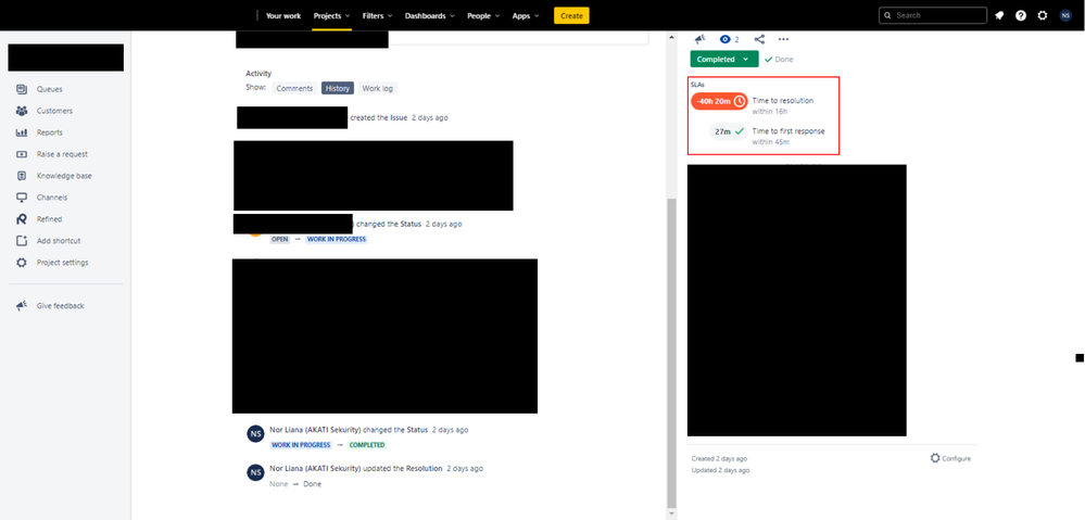

Most of our tickets were Resolved manually through the Resolution field.
But the thing is, it shown as overdue even before Resolution status is changed. For example, I resolved a ticket 3 hours after creation, within the SLA of 16 hours, yet it had already shown as overdue of -40h.
October 14, 2020
Morning GƶkƧe,
Below is a sample of issue history (with confidential information redacted). The SLA configuration is the same as the one shown in the main post (or is there somewhere else I need to check? To be honest, it is a bit confusing going around the project settings in Jira, so I might be missing something).
As we can see, it is created and resolved within the same day, yet the SLA shown it to be overdue at -40h 20m. A significant difference. It shouldn't be overdue, as the Time Goal for this one is 16h.
To note, the overdue SLA had shown to be in the rest even before I resolve the ticket, which is...absurd, considering I resolved it 3 hours after creation.
Gökçe Gürsel {Appfire}
Atlassian Partner
October 16, 2020
Hi @Nor Liana (AKATI Sekurity) ,
Can you send a screenshot of your SLA definition?
