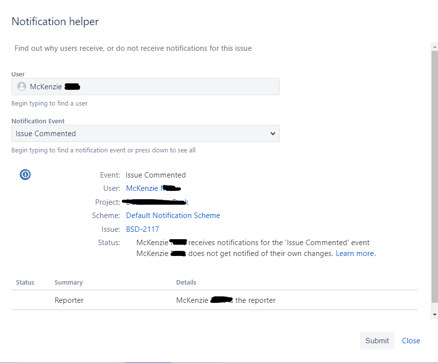

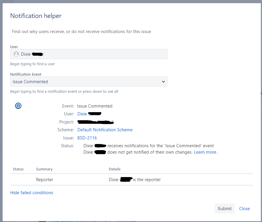

We are seeing inconsistency in notifications when service desk customers who have been set up the same way submit tickets but sometimes will not receive an email notification when the ticket is commented on by someone else or the ticket status is changed. Screenshots are of two tickets submitted by two customers. BSD-2116 received an email that the ticket was submitted but did not receive an email when I commented in the ticket or changing the status. BSD-2117 received an email when the ticket was submitted and when I commented on the ticket and changed the status. However the customer from BSD-2117 had been complaining before testing this that she was not getting email notifications. Has anyone had this issue before? Please let me know if any other information is needed.

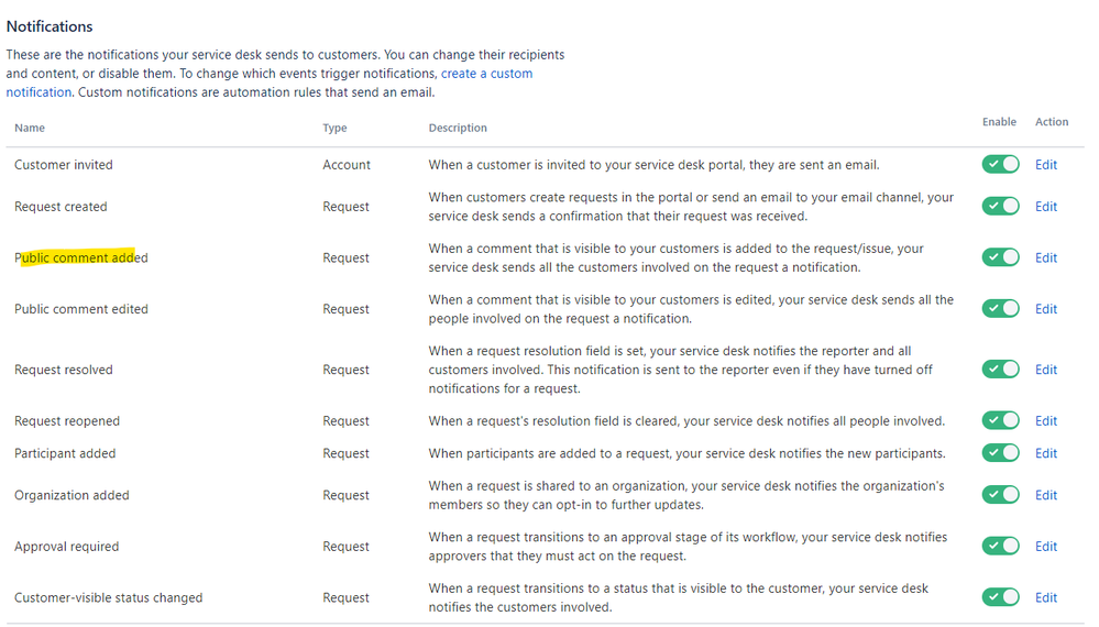

Hi @Adam Rypel _MoroSystems_ thank you for taking a look at this, it looks like all customer notifications are enabled for this project. And yes, request type is filled in.

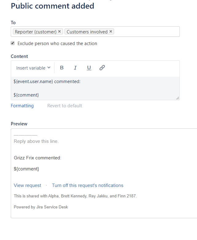

Can you please also check if everything is set correctly when you click Edit next to the desired event? There should be "To" field filled in.

@Adam Rypel _MoroSystems_ Looking at them, the "To" field is filled in for these.
