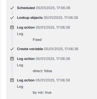

What I'm noticing is that if I do a direct comparison using the {{lookupObject.first...}} smart values, it always evaluates as false.
So, this line will always return false no matter the actual value:
{{equals(lookupObjects.first.First Level Approval, "Fixed")}}
However, if I save that value to variable first, it works just fine.

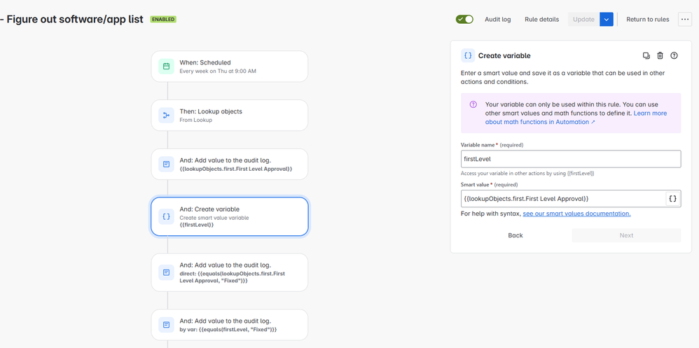

So, I create a variable called firstLevel and assign it the value of
{{lookupObjects.first.First Level Approval}}
and then use the following smart value, it compares correctly and will return appropriately
{{equals(firstLevel, "Fixed")}}
Here is screenshot of an automation I used to test this and the resulting output
