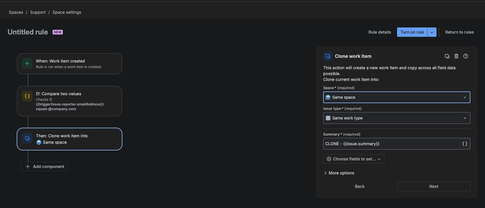

Yes I also figured out this SmartValue, but did not find a way to select the space name dynamically. Since I have to select the space I want to create the work item, I can't put a dynamic value to space name. Is there any way that you know to do that?

You can't do it dynamically but you can use an if/else block, e.g.
if 'company domain' = acme then create in the acme project
else if 'company domain' = bobspizza then create in the bobspizza project
else....
