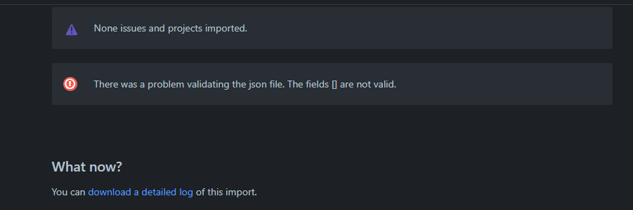

I am trying to import tickets with agent-customer interactions from a different helpdesk system using JSON. I get an error that says "There was a problem validating the JSON file. The fields [] are not valid. I tried removing the [] it succeeds but no tickets or issues are generated. How do I go about doing this?

Hi @Mahad Uddin
How does the JSON you try to execute look like, this will greatly help community members to help in resolving your issue.

Hi @Mahad Uddin
Can you make a screenshot of a single issue?
You can also make a csv export and try to import it this way.
Is the system you exported from also Jira or different? If different look at the API documentation on creating issues
https://developer.atlassian.com/cloud/jira/platform/rest/v3/api-group-issues/#api-rest-api-3-issue-post

I am not sure what you mean by screenshot of a single issue? Do you mean a couple lines from the JSON that I had exported?
The system is different. The JSON export from my current system is vastly different from what Jira requires. Atleast that's what I have figured out in my extensive research lol.
And I have over 120 JSON files with no technical coding skills lol. I can't possibly modify all those JSON files I have exported to match to the Jira requirements.

Hi @Mahad Uddin
You will need to as, Jira requires the JSON to import to be formatted in a certain way, as shown in the API documentation.
You export is in JSON from a different system, that system also has it's own formatting.
They use the same language, but not the same payload option.
