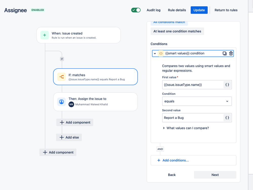

Hi @Kai Becker
Thanks for the info i already did try this but the issue the rule is not picking up the issue type by name. Let me know if i am doing something wrong because i checked the audit log as well and it said nothing to be changed here.

Hi @Muhammad Waleed
is "Report a Bug" the issue type or is it the Request type?
Request types are based on issue types, but add a separate layer of configuration on top in JSM projects.

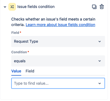

Also be sure to use Issue fields condition instead of JQL or smart value, as it will be faster and is a lot easier to use, because of the auto complete:

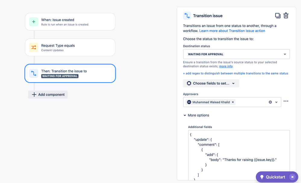

Hi @Kai Becker  Apologies to ping again i did as you told me but the transition rule is not adding any approver.
It shows me this error.
P.S I have added the rule details as well.Screenshot 2024-02-20 at 3.43.22 PM.pngScreenshot 2024-02-20 at 3.43.39 PM.png

Hi @Muhammad Waleed
the error messages states, that the fields are not configured in the transition screen. If they are not present, Automation is not able to fill out the fields.
Could you verify that? I would first try to add them there, if they are not present.

Muhammad Waleed
February 21, 2024
I have used a workaround where i have used Edit issue option and added an arppover separately.
Thanks for the support.
