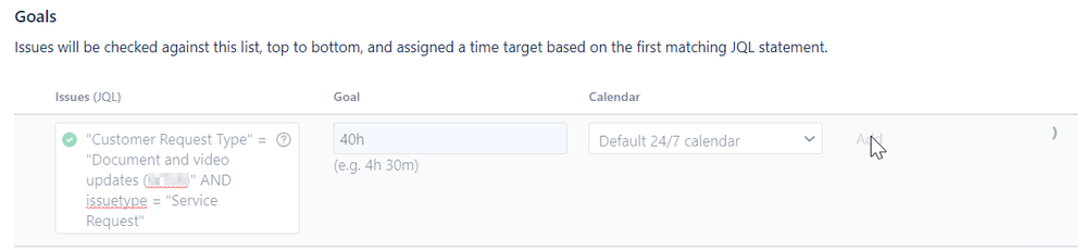

Hi , I am facing some issue while setting up SLA Goals. I tried to input a valid JQL query in the goals section and system shows no JQL error, still the Goal is not letting me add it while I click on "Add " button. The hour sign just keep rotating.

that doesn't sound like an error associated with the JQL. Have you tried another JQL and found it successful? How about simply "Customer request type" = "Document and video updates (????)"...leave off the last bit since I would think it would be redundant anyway unless you have that same CRT associated to a different issuetype.

Hi Jack, Thanks for the note. I did try the suggestions ( Just use"Customer request type...." still the same issue.

ok so try something completely different. if it is still an issue I believe you have something going on w/ your instance, i.e. not associated w/ the SLA goal. Do you have a lot of goals for this SLA by chance?

@Jack Brickey -  I believe the problem is only when I select "Customer request Type =...", because if I just add "Issuetype=...." in JQL it adds to goals.

well that is certainly interesting. I'm not sure why that would cause an issue and would suggest submitting a support request. It doesn't cause an issue for me but i'm on cloud so that is of little value. I also too a quick look in JAC for any bug report but did not find anything.
Should you find the answer please post here.
