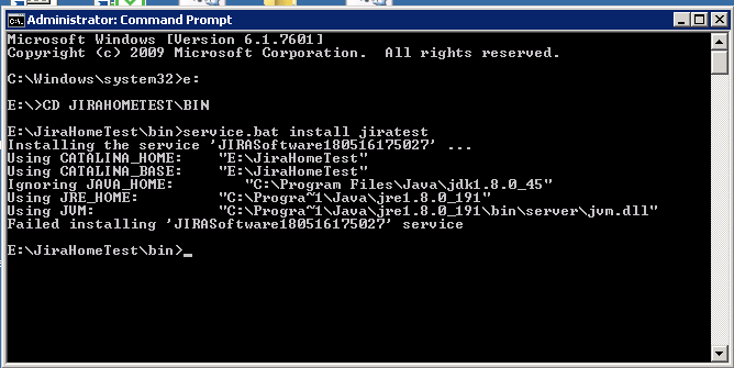

We have copied the PRD setup and we are trying to get test up and running using the dev licence.
But we are having issues manually installing the Jira service for the test application.
Thanks,
Mark
Shankar Asam {Appfire}
May 2, 2019
What is the error/issue? Can you provide it here?
-Shankar
Garvan Murphy
May 2, 2019

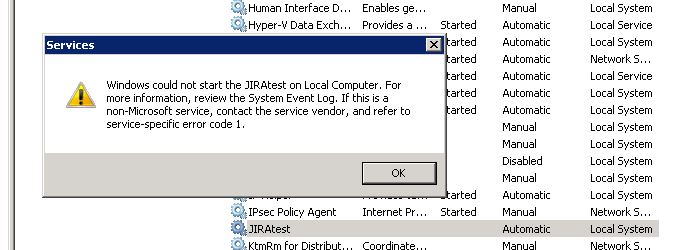

Garvan Murphy
May 2, 2019
Garvan Murphy
May 2, 2019
Got service installed but cant start it
May 3, 2019
Can you go to the event log and provide us the error when starting the service?
