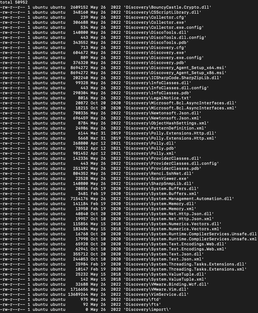

What are the permissions for Discovery.exe?  Can you run "ls -l" on the directory and show the output?

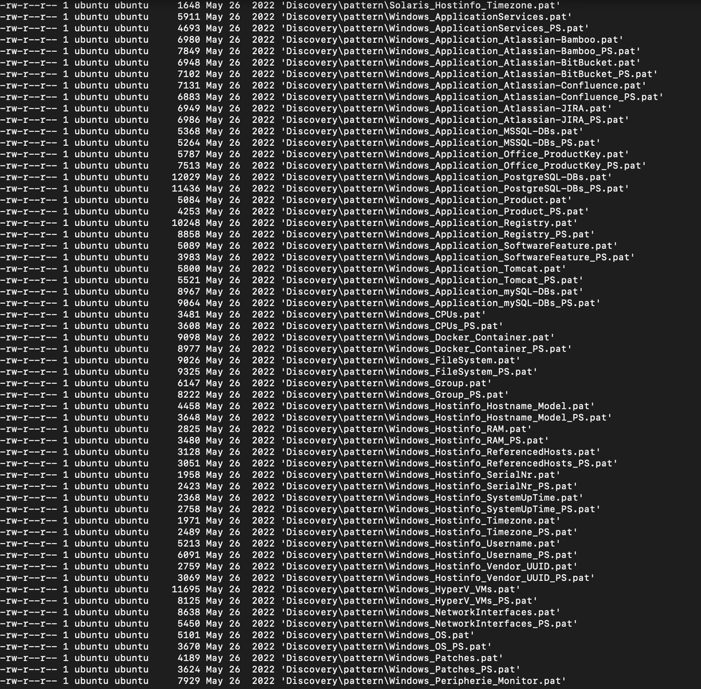

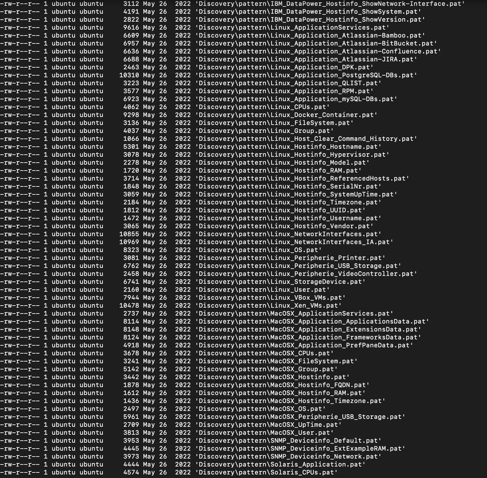

Cami Jara
November 28, 2022
Screen Shot 2022-11-28 at 10.06.41 AM.pngScreen Shot 2022-11-28 at 10.07.21 AM.png
I have also tried mono <full directory path>/Discovery.exe -s

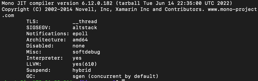

Cami Jara
November 28, 2022
Screen Shot 2022-11-28 at 2.50.15 PM.pngI installed mono by following the instructions here for ubuntu. This is the version I am running (included in the screenshot). I have also run the sudo apt install mono-complete command and it made no difference  https://www.mono-project.com/download/stable/#download-lin
